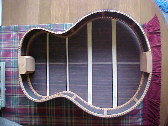

Here is the outworking of my first OSJ on the bench, not necessarily what I thought either.
Body length: 19 9/16"
Lower Bout:   15 1/8"
Upper Bout:   11 3/16"
Waist:        9 1/4"
Tail:        4 15/16"
Neck:        3 3/4"
That's my story on the OSJ and yes, the tail got a little large didn't it? This guitar is for my son he helped build the mold and bend the sides.
PostPosted: Tue Jun 12, 2007 2:28 am
Hum that means that the Ameritage AM-32 is not designed around the Olson SJ then because the body you show here is 15/16" shorter than the the body the Ameritage AM-32 is designed for.
